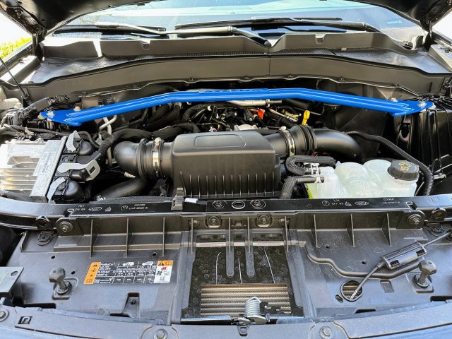

Installed the Steeda Strut Tower Bar, really nice part!

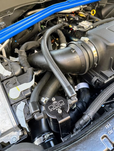

also installed the JLT J&L passenger side oil separator - really nice kit, fits PERFECTLY

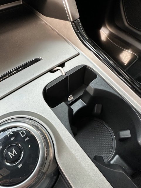

installed the Tim McFadden phone holder - definitely want to use an Apple charging cable since the generic ones didn't space properly - with the Apple one, it's a perfect fit

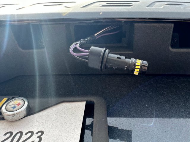

also upgraded the rear lighting from Travis Ellisor from Houston Speed Freaks - these lights are BRIGHT, really helps with the 5% tint visibility!
replaces the rear amber signal/flasher, backup light, and the license plate lights...
NO issues with CANBUS either, no superflash, no errors - well worth the upgrade!

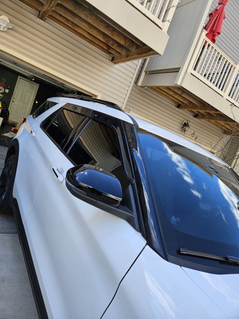

I added AVS vent visors today.
Interesting that yours appears to be the original design. Steeda for a time had been selling a brace with bends towards the ends and didn't fit so well. I wonder if they just screwed up batch and now have it corrected. Personally, I like the original (the one you have).
This is CajunHeat's.
Toadster
324
197
Folsom, CA
interesting are there spacers in the front bolts on the black one? I can't tell..
