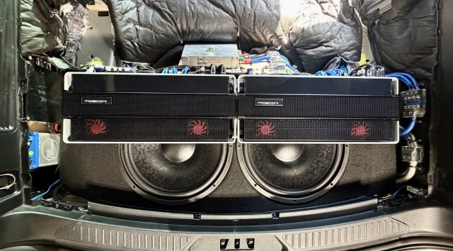

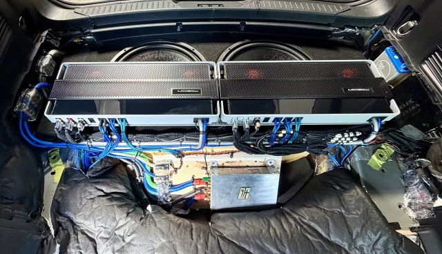

More audio stuff today. My amps use unregulated power supplies so their output goes up with voltage…which means it also goes down. Our BMS has voltage all over the place from 11.6 all the way to 15.5ish but mostly around 12.6 when driving on mine. There’s an audible difference when the voltage goes to 14.4 or higher so I added a Harrison Labs FluxCap voltage stabilizer and now it’ll maintain 14.7 no matter if the car is on or off.

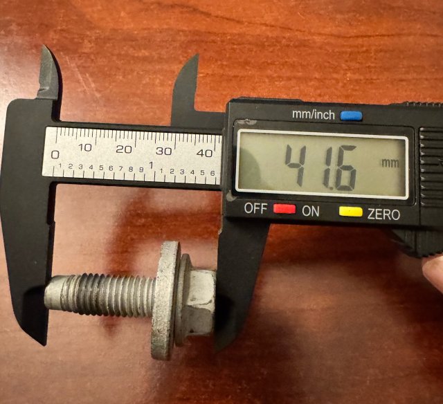

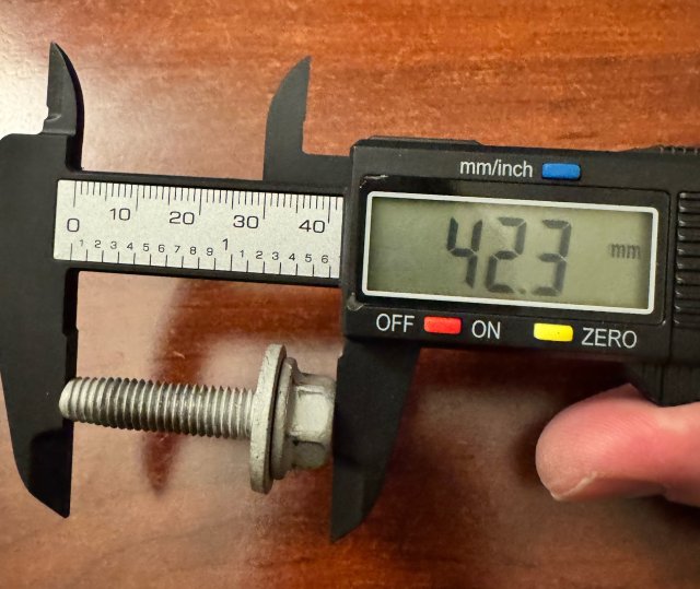

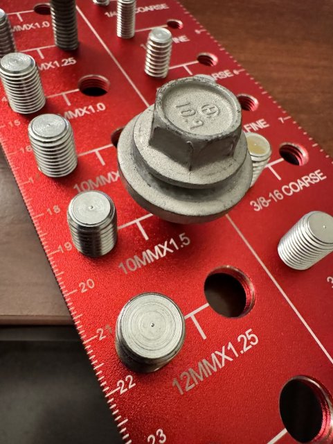

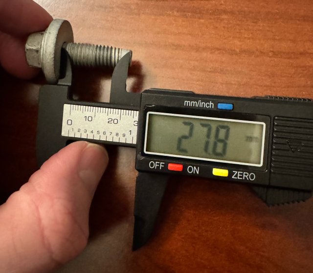

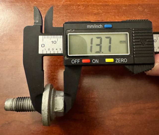

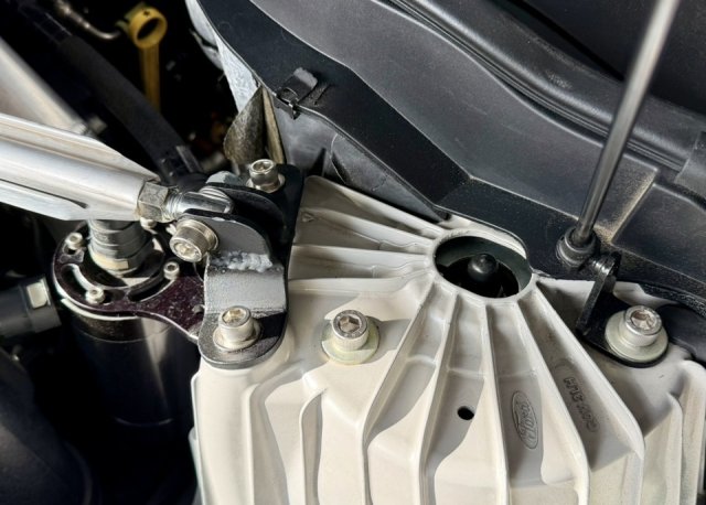

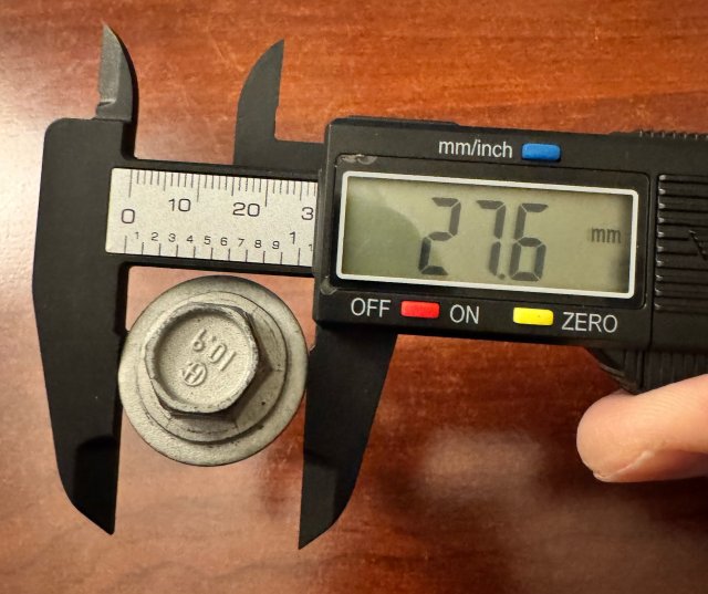

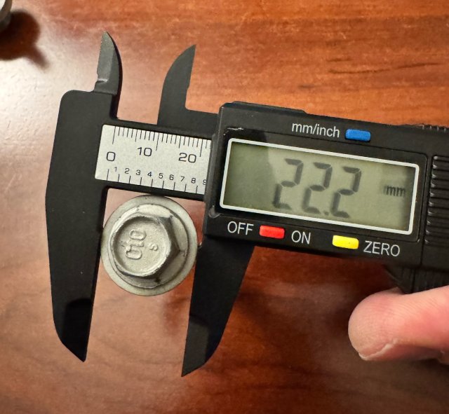

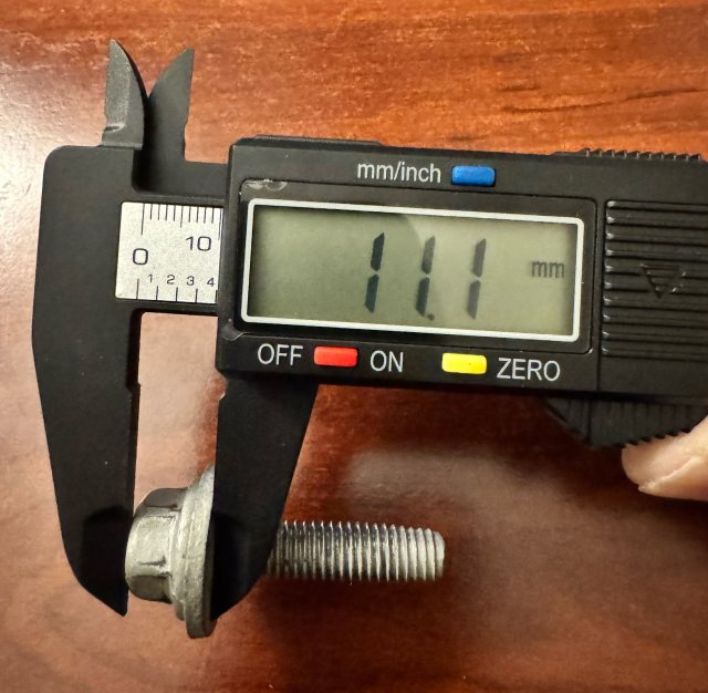

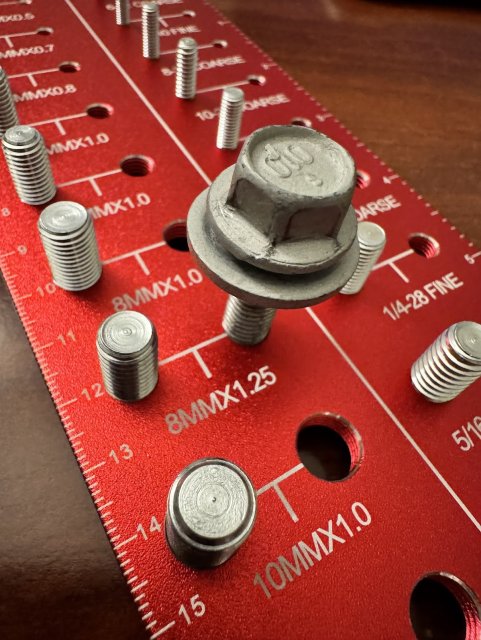

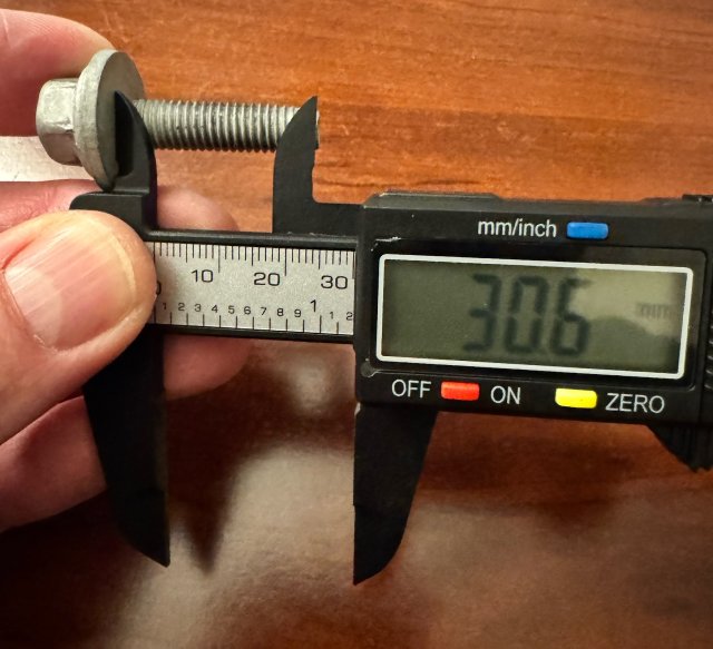

292
138
2025 ST
Hell I forgot already. I just popped one of each out and ran to Ace. lol
Copy. I’ll take one out and measure it and report back. Are the all the same?
5,797
7,003
Thread Starter #1,437
No the strut mount bolts are bigger than the strut bar bolts.
