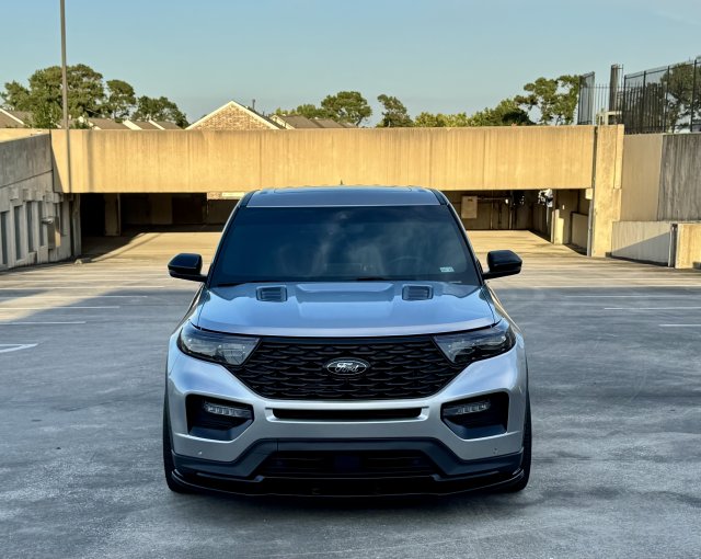

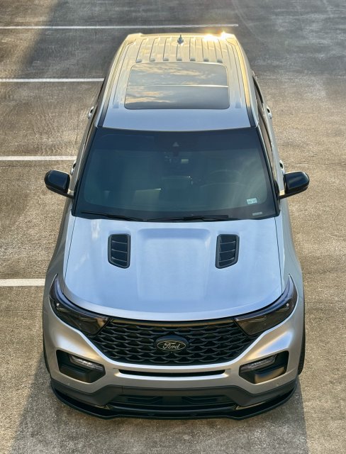

It came out as well as I could have hoped. Pretty much spot on to my “render”. Still needs a lot of cleaning and paint correction on the rest of the car and I can’t wait to get the new wheels on. View attachment 28223
really love the hood vents, it came out perfect.
around how much did it cost to fabricate? im gonna start saving for this as my next mod
I did all the fab work myself. I’ve heard others quoted north of $2K for fab and paint. The cut up Jeep hood and new vents ran about $200, supplies were another $300ish then whatever it cost to paint but I had other stuff painted at the same time so I’m not sure what the hood alone was.

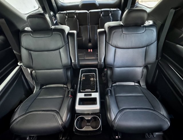

Back in town after an extended work trip. Picked up the newly upholstered shortened headrests to replace the others I had installed. These are the factory parts that I shortened 4” myself. They’re wider and match the lines of the seats better. IMG_7042.jpeg

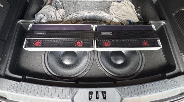

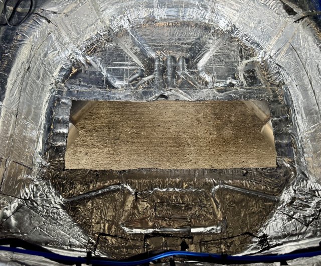

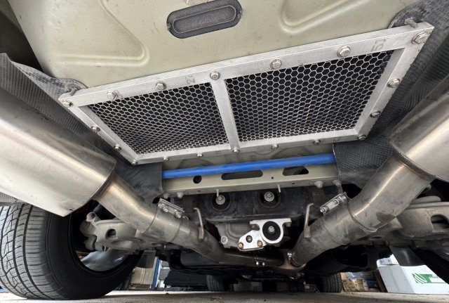

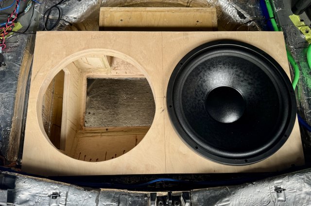

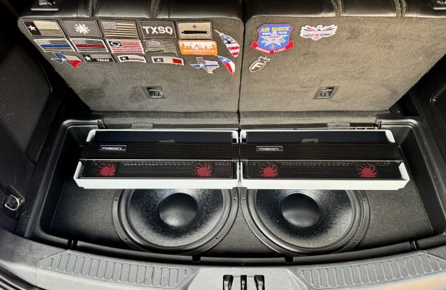

So a month or so ago I removed all of the audio in the back. Subs and amps were sold off and the new stuff has all been acquired.

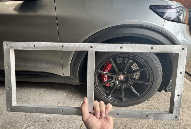

I have a pair of Mosconi Pro 5/30’s that will be split with one running each side of the car and a Pro 1/10 that will run the Audiomobile Evo 2408 sub that’s getting built into the glovebox area in the next few weeks. The sealed enclosure was cut up and massaged to hold the pair of Acoustic Elegance IB15AU’s I had built for this upgrade. The floor was cut out and will be reinforced with a 3/4” thick 7075 aluminum stiffener ring combined with some aluminum mesh and hydrophobic foam to prevent water intrusion. I was making good progress today until the rain decided to blow in. I should have the manifold finished and installed tomorrow and hopefully adding electronics back in by tomorrow night. IMG_7125.jpeg IMG_7128.jpeg IMG_7056.jpeg IMG_7132.jpeg

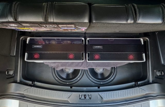

The 5/30’s will float over the 15’s something like this. The 1/10 will be hidden along with all the other electronics. The only thing I want to see is two subs and two amps…no wiring or anything else. IMG_7133.jpeg

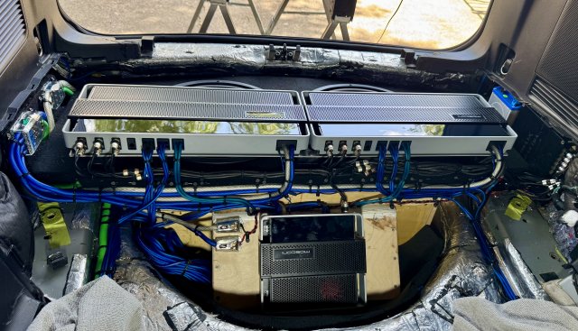

Sneak peek…ready to start wiring.
The finished vent through the spare tire well.

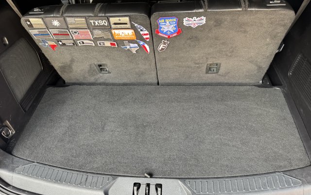

All wrapped up.
The 3rd amp is hidden and ready for the front sub that’s coming soon.

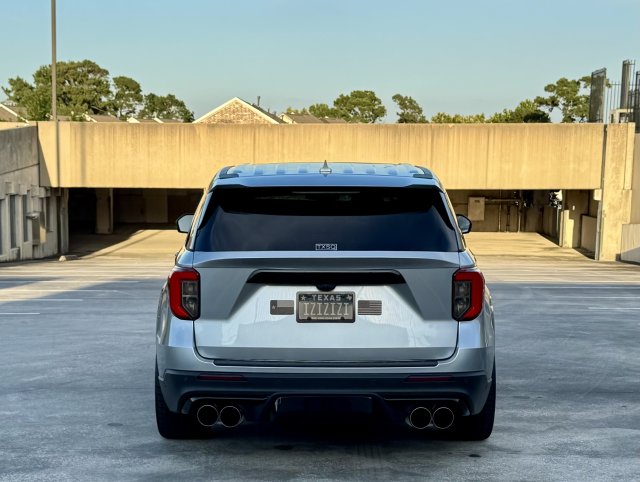

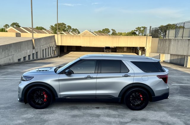

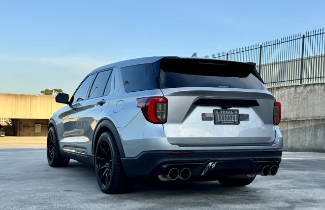

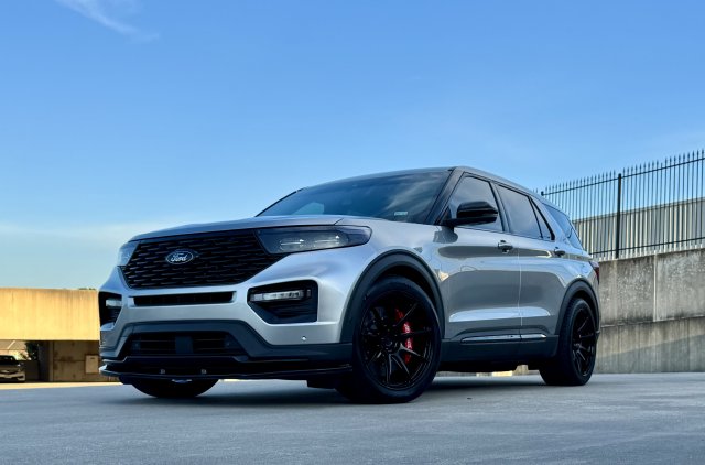

Random wash day pics. I still love this damn car IMG_7262.jpeg IMG_7270.jpeg IMG_7279.jpeg IMG_7286.jpeg IMG_7294.jpeg IMG_7299.jpeg
