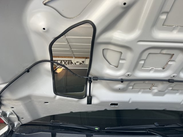

Haven’t cut any holes in a perfectly good car lately so….
Decided to do the Jeep Rubicon hood vents. Final fit/layout check. IMG_0747.jpeg
These vents were chosen because their curve matches the hood perfectly. IMG_0750.jpeg
Inner cut liked with pinch weld moulding. Can’t have a raggedy cut showing. IMG_0751.jpeg

I have a plan for the underhood insulation…it’s cut to fit but I need to hem the edge. I’m just gonna staple around it to close it up then put more pinch weld moulding around the cut edge. IMG_0755.jpeg
And one last shot outside. Car hasn’t been washed in a couple of weeks…don’t hate on the filth. lol IMG_0757.jpeg

Looks sharp. How does the water drain out from the vents?
5,849
7,096
Thread Starter #1,009
I positioned them so it basically runs down the inside of the strut towers. The right side vent is just behind the ECM and both are just in front of the plastic cowl cover.

The final thing to finish up was closing up the cut in the underhood insulation. I don’t love it…but it’ll do until I figure something else out. I stapled it shut and used pinch weld moulding around the edge.
63K miles and she still cleans up ok I guess.
59
34
Houston
least it looks more finished than before. You concerned at all about the insulation getting water trapped between it and the hood?
5,849
7,096
Thread Starter #1,016
Not at all. I drove in an absolute flooding storm in LA on Monday then washed it today and sprayed water everywhere…there were maybe a few drops under the liner.
