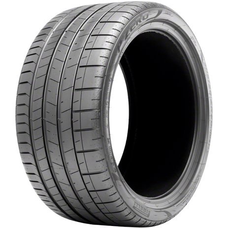

315/35/22’s square...think I will.

I think this will be it. 325’s would need an 11” wheel imho and that’s too tight up front.

are those pirellies load rated for an SUV?

Yes. They’re 111Y XL

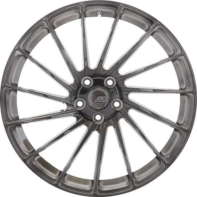

what offset on an 11" wheel do you think would fit? 28? 25?
135
64
Canada
how about going up in size - like to a 23" wheel. 23x11 BC Forged...mmm mmm mmm!!! seriously drooling right now! LMAO! what offset do you think would work?

I’m not gonna guess at an offset for an 11” wheel up front. Clearance would be way too tight for my liking.

If you don't mind, could you post up some pics of your wheel's clearance at full lock in both directions? or @sleekone i know you have a similar setup, could you post some on your build thread? i would be curious to see just how much room we have to work with on both the fender and the suspension bits...

I’m out of town all week so I can’t get pics. The clearance issue with an 11” wheel and tire is at the strut...with a 10.5 +30 and 305/35/22 there’s barely 1/2-5/8” clearance there now. When I go to 315’s that will shrink to 3/8” give or take a couple MM.
