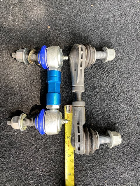

Experimenting today. I ordered Steeda adjustable end links for an S550 to play with. I had to cut off about 1/4” of threads on both ends to bottom out the joints to get a little more adjustment out of them...other than that they fit perfectly and flatten the bar about 1 1/8” so the bar ends are allllmost back to their stock position. The fronts would work on length unfortunately the studs are too small diameter. I’ll be having a set of those made here shortly. Still no off-the-shelf solutions but I’m working on it. C80F7392-0F94-4C26-A139-A9FFE87E79D5.jpeg 1E74603F-11C0-44FA-8252-F65A3B3FA8BB.jpeg

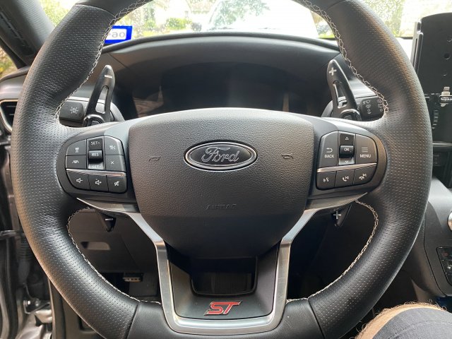

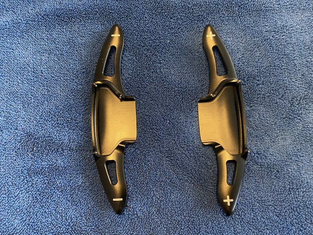

Shift paddles...finally.
843C5EDC-5429-4C58-957A-7E4A86375BB1.jpeg BDB25EE9-5D2F-4A07-8EC3-04791833EBAB.jpeg

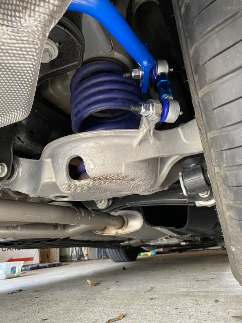

Just out doing minivan stuff...hanging with Camaros, Mustangs, Chargers, Challengers and an AMG Benz on the twisties. Steeda rear bar on the firmest setting...pushed it hard enough for the tires to howl but couldn’t push it into oversteer. Our plan for the day was to double the speed limit through all curves...we went pretty hard. The only time I was nervous was doing 120 around a 60mph sweeper I thought was never gonna end. lol E03DE490-C6F7-4E8F-A6F4-218BB3F9079D.jpeg 94AB12D2-FE44-4354-8A02-64A823665EA1.jpeg

They look great! I’m having a hard time keeping up with everything on your build. Where did the paddles come from and is this a direct replacement? Thanks! Jim
Jim I posted the link and more pics in the Paddle shifter thread.
