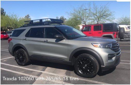

This is what the before and after would look like on 18” wheels. View attachment 2696
Your Pic?
2 inches on the AWD model cause vibration on accel. That tells you that serious mods would be needed for anymore. I am interested in 1.5/1.0 possibly. Haven’t decided.
Sent from my iPad using Tapatalk Pro
LokiWolf
586
323
Henrico, VA
I don’t have AWD model. This is 2WD model and was lifted by jack to advertised height to show what it would look like. Lift is not actually installed.
This is an ST forum...and ST’s have AWD, so the assumption would be AWD here.
