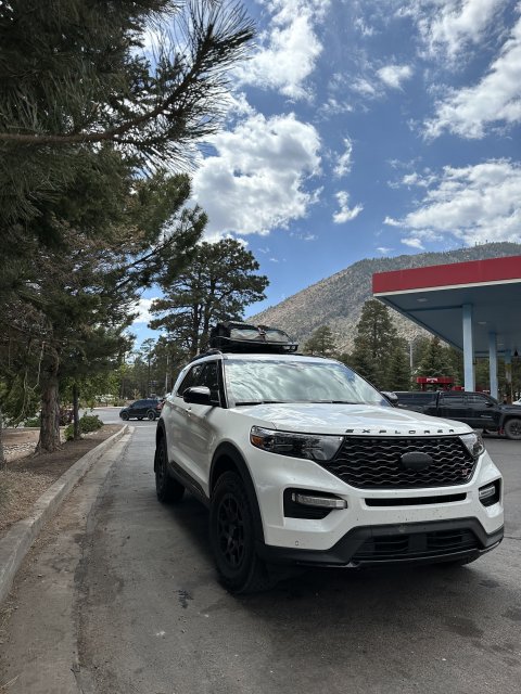

Got the traxada lift a few months ago. Feels great! Such a smoother ride with the 18’s. No real loss of power feel. Decent fuel economy. Zero vibration.
Not the best pics. Haven’t taken the time for a real photo shoot yet
Any issues since you installed the kit? Thinking about pulling the trigger in these...

Everything seems to be great! No wobbles or vibrations or anything. Been on a couple road trips now. Avg ~18mpg with the lift and roof rack
