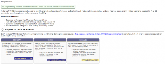

Don't know if this will help, I copied this off of Rock Auto's '21 Explorer page. They sell 2 different Motorcraft and one Schrader TPMS. All they sell are programmed.

Thank you for sharing. I will go review that in detail. I assume the sensors were pre-programmed but I will need to check with the tire shop….unfortunately that shop is 5hrs away so can’t just pop by.
