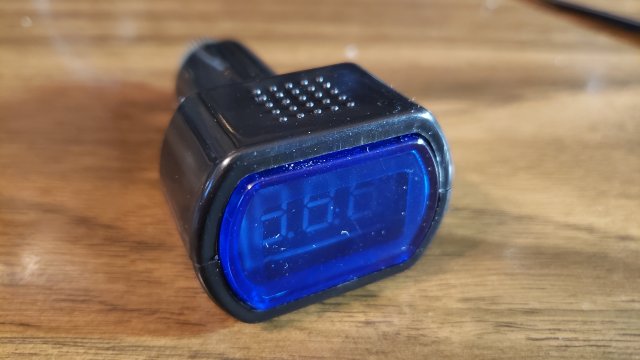

This is a voltmeter that will plug into a car 12 volt outlet. They are commonly available on the Internet. I leave it plugged into the outlet at the front of the console under the lid. It is easily readable while driving when the lid is opened. If I have just been doing short trips it will show 14.7 volts while driving, bu if I drive on a longer trip it will reduce to 12.9 volts. This shows that occasional longer trips are required to keep the battery properly charged. BTW the power to the outlet is automatically removed a few minutes after the car is turned off.
This is one example:
https://www.amazon.com/Zeltauto-Cig...locphy=9023859&hvtargid=pla-568712381669&th=1
Oh wow that’s awesome. No idea that existed or even was possible. Will order one that also adds usb c and a.
Also, I’m out of the country this week and measured my battery at 12.6 volts right before I left. Curious to see what kind of drain I’ll see just from sitting.
