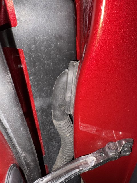

Anyone know how to get these plugs out for the door speakers? I am running new wire and want it inside the boots…. IMG_2285.jpeg

Anyone know how to get these plugs out for the door speakers? I am running new wire and want it inside the boots…. View attachment 33726
It’s been a few years but they pop out and give little room for hands. Spray silicone helps them slide a little better if they are super tight. That was the toughest part of my install.
