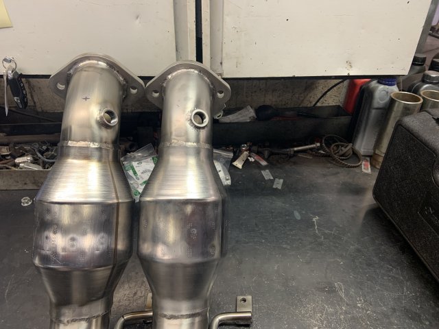

UPDATE: the alignment was off on the O2 sensor hole when machining the left pipe. Sounds like a one off issue but better heads up than surprises. Good news is, Jacob at SPD was awesome to work with and super responsive - a replacement pipe has already been shipped overnight so should see it as fast as Canadian customs can clear it!
had my tech talk directly to Jacob - could have also had a local machine shop relocate the hole but I felt I’d rather have the fit and finish of a new correct pipe.
not pleased it happened but SPD made it right and quickly, so all good!
So are they said it was just your set or all?
That’s good and we all have a pic for reference now to check ours against.
2020 Explorer ST - Storm Trooper Build
Borla S-Type Exhaust | SPD Downpipes | Vossen HF-5 | Michelin PSS Tires | Speeda Rear Sway | Turbosmart BOV | Rear Wiper Delete | Clear Bra | Tinted Headlights | H&R Springs | Custom Carbon Fiber Steering Wheel | Custom Front and Rear Emblems
Not sure if it was just mine or others but I’m sure if there are others they would reach out and make it right. (y)

Well...here’s another one from FB. View attachment 1669
Well damn....

That's concerning.... I was hoping qc would be a little better.
I think I'll hold off on purchasing these until the bugs are worked out.

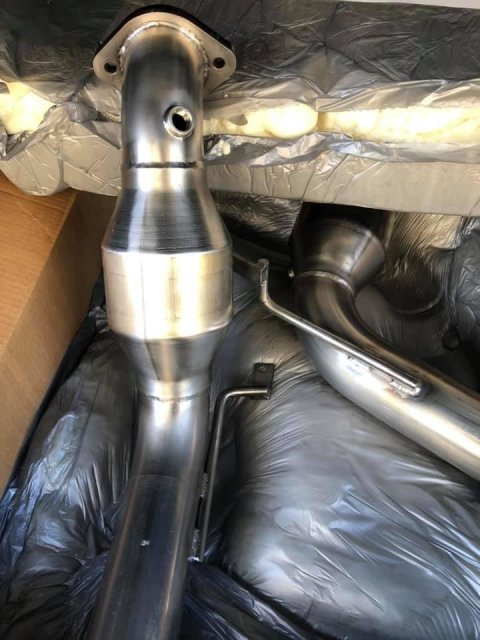

UPDATE: new pipe arrived yesterday - overnight shipping was no joke. Everything lined up and installed no further issues.
ATAK exhaust with the downpipes definitely sounds badazz AF! Getting that beautiful snap crackle pop!
93 tune woke it right the F up, no slouch!! Gonna do some pulls later tonight or tomorrow and see where it’s at. SPD Performance - no regrets!!! (y)(y) 176C68C7-ED1A-4AC4-81B9-0AE7455C682A.jpeg
