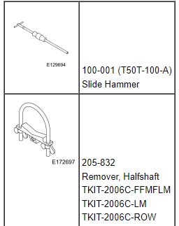

What does the ford specified puller tool look like?

Just an fyi, you can weld a exhaustclamp to some square tube and add some square tube at a right angle to bang on.I made one up in about ten minutes and it works well.

I did something similar. Used a exhaust clamp u-bolt, some angle iron, some 3/8 keystock and a large nut. I had to buy the keystock anyways, to pull the dang fill plug out of the diff, since there's not enough clearance for a ratchet.
