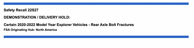

2020 Ford Explorer suspension TSB (Bulletin SSM 50471)
Bulletin Date: Feb. 7, 2022 Component: Suspension. Bulletin Summary: Some 2020-2022 explorer vehicles may exhibit a rear axle mounting bolt that has broken. In order to correct the condition, the rear subframe, differential cover, and mounting bolts will need to be replaced in addition to any other damaged
406
225
Buffalo, NY, USA
It'ss a full blown safety recall.. not just a TSB. Dealerships wont be able to deliver vehicles to customers until it is fixed and we that have the recall can go and get the remedy as soon as it's availalbe.
I'm off today but will dive into the recall further tomorrow when I'm at work.
The letter sent to dealers states that just a PCM flash is the fix... i hope thats not the case.. lol

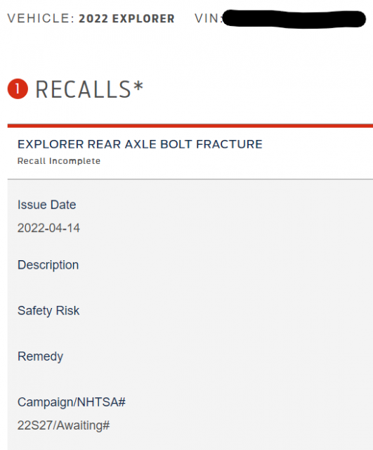

02/22 build. Has only 1 bolt. Was kinda bummed when I looked underneath. Just bought it back in March. Been excellent the whole time (one family trip to myrtle beach already under its belt. But I am curious what this fix entails. Would really like 2 bolts. Recall notice just popped up today on FordPass app.
