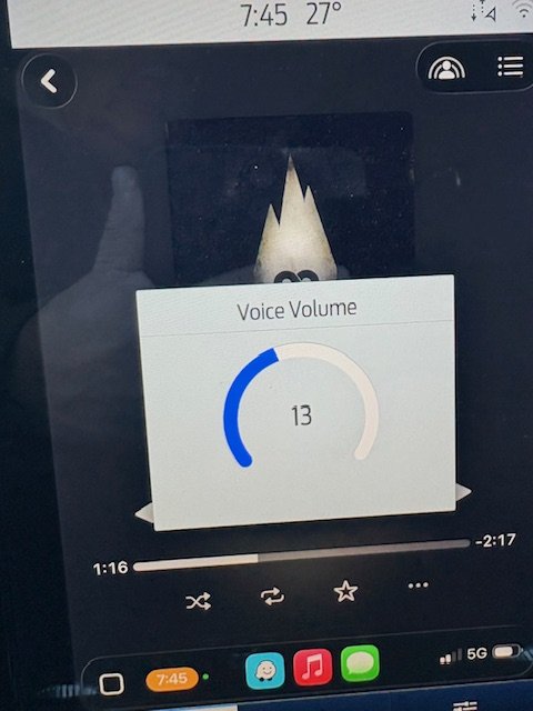

There is definately something going on and I don't know if it has to do with my iPhone or the radio itself. The power button, previous and next buttons don't work. When I turn up the volume, it displays "Voice Volume" instead of "Audio Volume". Also, if I switch from CarPlay to SirusXM, the song that was playing from Apple Music will keep playing. I can't hear it but it shows it playing on the screen. The other thing it's doing is, once in a while it will show that I have an active call from my own phone! Then it freezes up. Hitting the "End Call" does nothing. Why can't they just leave shit alone when it works fine?
