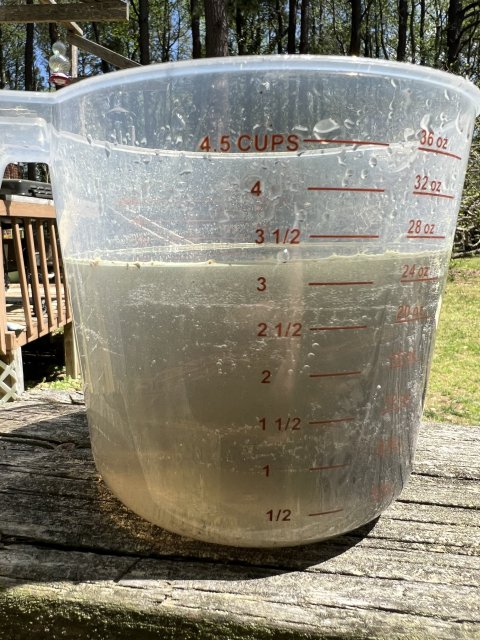

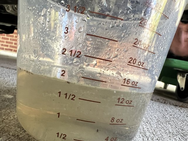

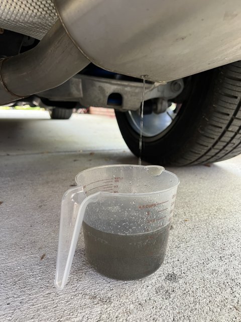

Believe it or not, 3.25 cups out of mine. The driver side was 2.5 cups, mostly just yellow. My passenger side was sooty, which lines up with my passenger side having terrible exhaust tip dirtiness. Still not sure why.

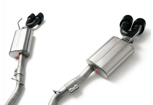

Installed Thermal 2.5" yesterday and it came with weep holes from Thermal.

#52
Very cool! Where exactly are the holes?
Not sure how to describe (backside of muffler inlet?) so I tried to markup (red) a picture with the location.
356
97
4 Main Street, Wichita Kansas
#53
perfect, basically right where I put mine on the 2.5”. This is a great exhaust. I’ve had it for like 2 years now and zero regurts
