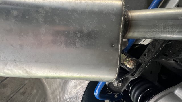

Thanks all for the input. I drilled two weep holes in the mufflers and drained just over 15 fluid ounces from the exhaust. Pics attached, and I promise it’s not pee. IMG_4890.jpeg

Thanks all for the input. I drilled two weep holes in the mufflers and drained just over 15 fluid ounces from the exhaust. Pics attached, and I promise it’s not pee. View attachment 22695
Can you post a picture of where you drilled the holes? It might help other members if you would, thanks.
