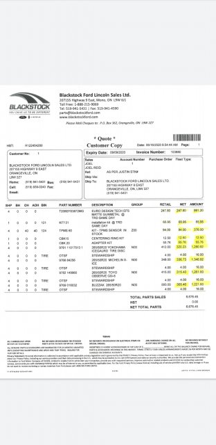

Give me an hour or 2 & I will send you all my info for my aftermarket winter tires. Hopefully there is a model number for the rimes

Here you go. Price is in Canadian. I went with the Euro tech rimes with the Blizzak tires & tps sensors. The model number is in the left side for the rimes.
