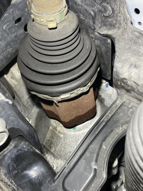

I've got a 21 ST which I did the actuator recall on and replaced the diff fluid. Now a year later and I noticed quite a bit of diff fluid on the bottom of the diff, passenger side. I could trace it up visually to where the axle goes into the diff. I'm assuming a seal there has gone bad.
Anyone else have this issue? Should it be relatively easy to pull the axle out, unbolt that diff cover, and replace the diff cover seal and whatever seals around the axle that slides in?
It's hard to search for this problem because every result comes back with the common actuator leak but this is the passenger side.

It seems like CN1Z-7H424-B might be the part number for the axle seal that's leaking. But I can't find a proper diagram of the diff. I'd really like to see it broken apart because I'd kind of like to remove that whole passenger cover to inspect and drain the diff. My drain bolt is stuck in there and I can only remove some fluid by suctioning it out the fill hole. But I don't know how that cover seals or if it is tricky to detach.
Side note: do those drain bolts use a special socket that is not a torx? Like a torx plus?

You will spill front diff fluid once the passenger axle is removed so you will need to top it off. The front diff drain plug is torx. you may need a breaker bar to loosen it. Still, if you managed to loosen the fill plug, that is all you need.

I did actually manage to complete this repair. I didn't remove the diff cover, only the axle and then diff seal. And I was able to remove the drain plug with a torx plus socket and some luck. I replaced it with a new plug from the dealer and new axle seal and the leak has stopped.

I appreciate you coming back to update this thread. I’m confident i can get the axle out. Is the seal easy to replace once the axle is out and was the part number CN1Z-7H424-B correct? Thanks

Yes, CN1Z-7H424-B was the part number I used at the dealer for passenger front axle seal. It wasn't too bad to replace. It was definitely in there tight, but I was able to knock it loose with a flathead and hammer. Carefully to avoid scratching up the mating surface. A seal puller would have made it much easier. It's a big seal, so easy to get access to. The most difficult parts were prying the axle out, and popping the old seal loose. A large pry bar, seal puller, and seal install kit would make this whole job quite easy.
While you're there, the axle nut is supposed to be 1 time use and they're cheap, so I usually get a replacement at the dealer. And a tube of ford ptfe grease which is applied to the splines on the axle shaft when you reassemble to stop the clicking issue Explorers get.

Thanks for the help and giving me confidence to tackle it. Wasn’t too bad at all. Hardest part for me was seating the new one all the way. I bought a cheap bearing drive / seal installer tool like you suggested but the sway bar was in my way so had a hard time driving it in. Finally decided to jack up the driver’s side which moved the sway bar out of my way and it went right in with a few good knocks. Funny, the hardest parts you listed ended up being the easy parts for me. Greased the axle splines but I’ll need to grease the others soon because they all pop.

Wifeys-ST, did you use a seal install kit? wondering what a. good one is. I too may have overfilled the front diff fluid. I get some seepage from the seal but waiting to see if goes away. May be doing this too. Thanks TangledPossum for the part#... I couldn't find it searching a Parts site.

not sure if this is the right tool but I used this. Worked okay. would have been nice if that bar was longer for this job. https://a.co/d/cIfaCXf figured I will probably find a lot more uses for it in the future.
And I used the cheapest 5$ seal removal tool it came out in 3 seconds on the first attempt.
