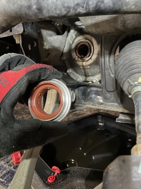

I did actually manage to complete this repair. I didn't remove the diff cover, only the axle and then diff seal. And I was able to remove the drain plug with a torx plus socket and some luck. I replaced it with a new plug from the dealer and new axle seal and the leak has stopped.

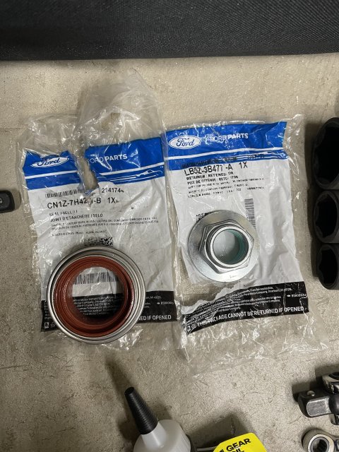

I appreciate you coming back to update this thread. I’m confident i can get the axle out. Is the seal easy to replace once the axle is out and was the part number CN1Z-7H424-B correct? Thanks

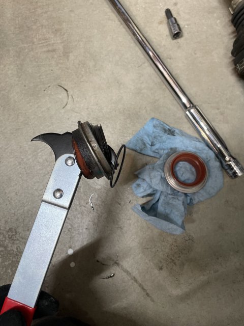

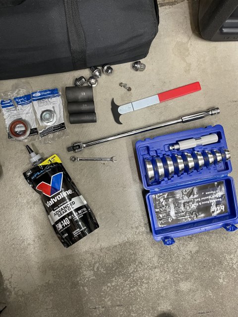

Yes, CN1Z-7H424-B was the part number I used at the dealer for passenger front axle seal. It wasn't too bad to replace. It was definitely in there tight, but I was able to knock it loose with a flathead and hammer. Carefully to avoid scratching up the mating surface. A seal puller would have made it much easier. It's a big seal, so easy to get access to. The most difficult parts were prying the axle out, and popping the old seal loose. A large pry bar, seal puller, and seal install kit would make this whole job quite easy.
While you're there, the axle nut is supposed to be 1 time use and they're cheap, so I usually get a replacement at the dealer. And a tube of ford ptfe grease which is applied to the splines on the axle shaft when you reassemble to stop the clicking issue Explorers get.

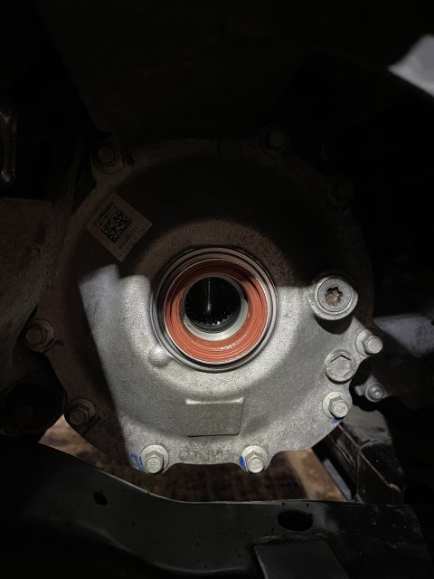

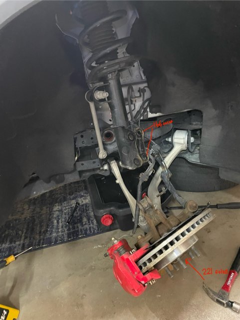

Thanks for the help and giving me confidence to tackle it. Wasn’t too bad at all. Hardest part for me was seating the new one all the way. I bought a cheap bearing drive / seal installer tool like you suggested but the sway bar was in my way so had a hard time driving it in. Finally decided to jack up the driver’s side which moved the sway bar out of my way and it went right in with a few good knocks. Funny, the hardest parts you listed ended up being the easy parts for me. Greased the axle splines but I’ll need to grease the others soon because they all pop.

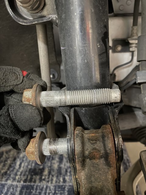

Funny, i didn’t want to drain the diff until i was sure the axle nut and strut bolts would break loose. Ended up forgetting to drain it and made a bit of a mess
