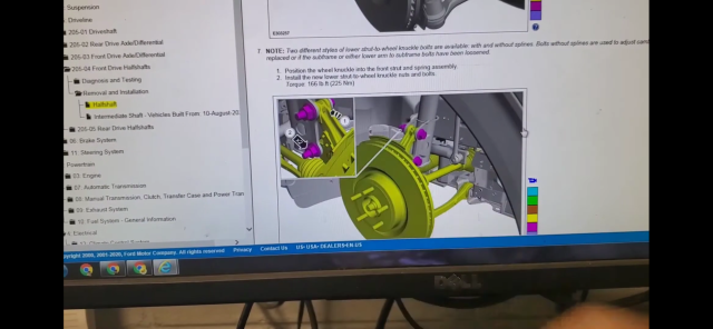

You're way off on the torque specs for the lower strut bolts. I added a Traxda lift to my 25' ST in Jan. or February of this year. I had to use my big torque wrench to torque them properly.

Also thanks Caster for posting the torque specs! I can't believe how high the spec is for lower bolts. I tightened mine down real good, but I might not even have hit 250. I'll need to recheck them next time the wheel is off.
Thanks for sharing this. It looks like we both have information from a trusted source that doesn’t line up. I have a 2020, maybe the splined studs are different. I used this vid from FordBossMe who is very trustworthy and he was using Ford’s Oasis database for the data.
This is the second time in 24 hours I’ve seen ford information conflict. The front diff drain and fill bolts say 30ft lbs on some guides and 18ftlbs on other guides. Guess it’s up to the owner to decide. I did my driver’s side to the same 166 ft lbs a year ago and hasn’t been an issue. My wrench only goes to 150 so I like to just hit it with 150 then a real solid ugga chugga past that
