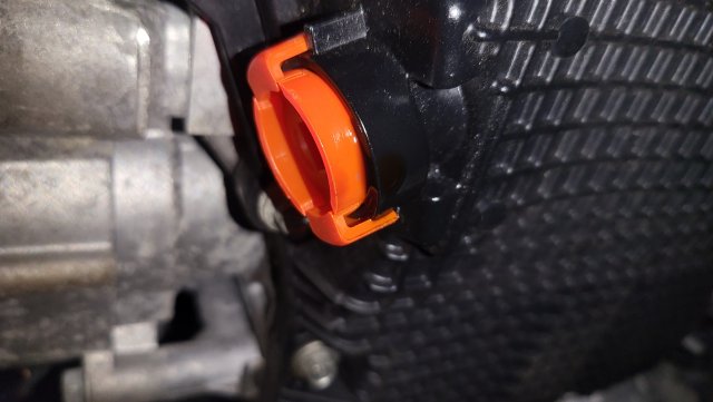

OK now I'm annoyed. Did an oil change and replaced the drain plug with a new one, made sure to oil the o-ring, and it's leaking again! This time seemingly even more.
What would be the cause of this?
View attachment 21748 View attachment 21749
Is that an aftermarket drain plug? The Ford ones are yellow and that one looks to be orange/redesh.

Thread Starter #19
Yeah I bought it off rockauto. Think one of the UPRs would fix this issue for me?
It is very possible the UPR plug could fix the problem since it has multiple o-rings verses the single one from the factory design. My UPR has never leaked.
If you decide to go the UPR route, do a thorough inspection of that area for any cracks before installing.
