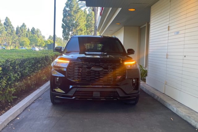

NOW POSSIBLE - Amber DRL/LED bars at nighttime!

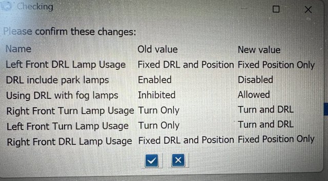

Works great on my 25! Thanks again!
Phoenix, AZ, USA

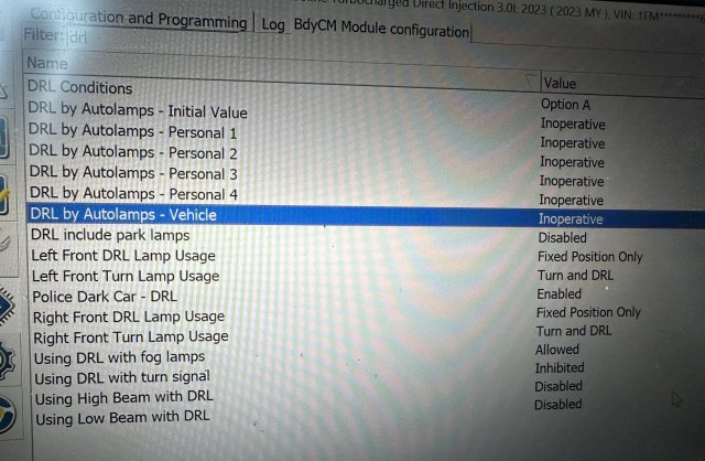

Worked perfectly on my 26! I was one of the ones that had DRLs disabled from factory, once I updated that the ambers worked as DRLs. Appreciate the tutorial!
svache
Hawaii
Thanks for the write up, it worked well on my (job 3) 2025!
Just one note for those coming after me: it says "Using DRL with fog lamp” -> change to “Enable” but I didn't see an "enable/disable" option. Instead, it was "allowed/inhibited". The setting was originally "inhibited", setting it to "allowed" made it work for me.
