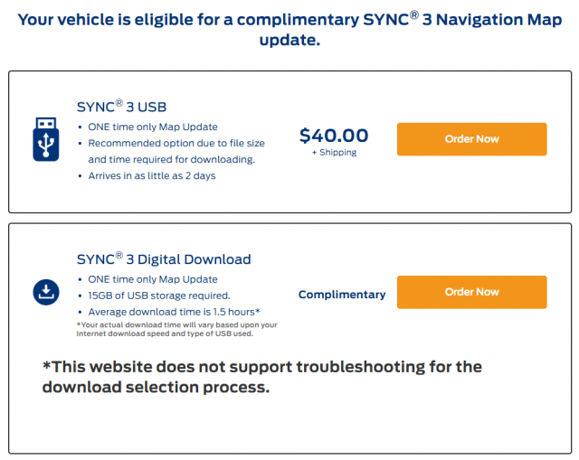

This is what it shows when I check with my VIN
Since mine is oct 2022 built, they might have a new map update for 2023(?)

Do you what know map version you have? Mine NA 221
Mine is NA 2 20
Yours looks like the latest version.

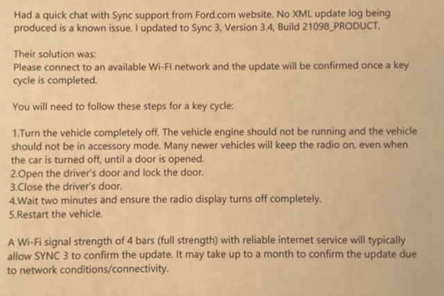

Just seen this on a different forum. It might help where Ford isn't showing your software updates.
Same BS answer I received. And I am supposed to rely the FordMyApp. What a joke

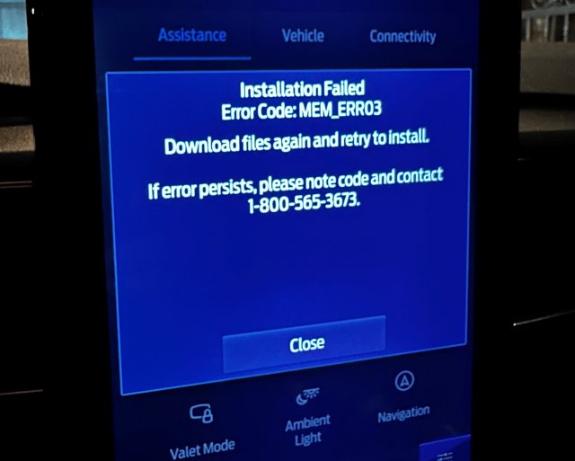

Wasn't as lucky when trying to install the maps with USB. Halfway through the installation and the following error showed up. Tried a second time and still same error. Performed a master reset and will attempt again tomorrow.

I suffered doing the last map update also. After 2 or 3 tries it worked but no problem with SYNC. Good luck,
