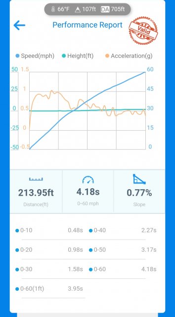

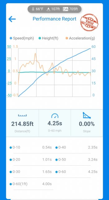

Loaded my 5* 93 tune today. Dragy times
Both these were in Normal Mode. TC off. 33 psi in the tires.

What RPM are you guys launching at?

2900 was what I launched at. Stock 21’s. Best luck with wheel spin was around 31 PSI cold.
Best E50 0-60, everything stock except Tune was 3.72 0-60. That was a cool night, on a dry flat road.
Use Sport. Shifts should be quicker, and you will gain a 10th.

Thanks for the tips. But in sport made its violent on the 1- 2 up shift. Maybe after the ZFG tune it will be better.

It should be quick and hard. I wouldn’t describe ZFG’s Sport WOT 1-2 shift as violent, but it is definitely solid!

I get a bad shutter.

Yeah, Sounds like typical 5*, based on what I have seen and heard.
