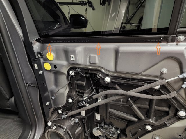

Ok, so I decided to give something else a try. I ordered some self adhesive velvet sheets and 1mm thick felt. If this all works out and anyone wants to do the same, I can link to exactly what I bought off Amazon for this.
After taking the door apart again I did notice that the foam washers I made really did get squashed down, so I created some new ones from the 1mm thick felt that I got, I have a feeling these will hold up much better and not crush like the foam. At the same time I decided to replace the paper ones as well with the felt. Getting those out was easy, but putting the felt back in was more of a challenge since they are much thicker. With a little patience and creativity those are all replaced.
Now here is where the velvet comes in. I am cutting strips to line all of the surfaces that come into contact with the door card and could potentially rub along the vinyl.
This is pretty much where I am trying to avoid any contact on the door card
Lastly, since I had it apart again, I decided to put some of the velvet along the tabs that lock the top piece onto the door itself. There are 9 of these areas that I did. I had only started when I took the photo.
Once this is all back together and I have some time with it I'll update this to let everyone know if it has really solved anything. Now it could take a little time to report back any success/failure since I am still having issues after the engine replacement and it's going back to the dealer Monday morning for that again.

The dealer had my vehicle for a few days this past week and there were some more creaks from the drivers side door after I'm sure it was sitting out in the sun. But it's still better right now. So, I decided to tackle the pass side and went a step further and did the following as well.
This track I removed and put some of the velvet on the area that touches the metal of the door (as best I could). When I pressed on this I could hear a very similar noise as well as when removing it (it just lifts out).
I only did that door like 2 days ago now, so that one needs a little time again to settle back in for me to see if maybe that is another part of the equation which I need to repeat on the drivers side.
This track I removed and put some of the velvet on that area that touches the metal of the door (as best I could). When I pressed on this I could hear a very similar noise as well when removing it (it just lifts out).

There are still some noises that are present and maybe someday I'll figure out, but overall I'd say it's 85% better still. Who knows, maybe some of those noises will go away when it's not 110+ outside lol.
