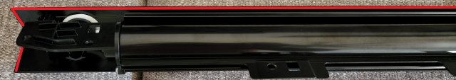

I did the passenger rear door today and took a few photos.
1. The 7 screws that attach the sun shade to the top trim piece, these are the ones I used paper washers on. I'll explain why in a couple photos.
2. The 5 screws that hold the shade to the door panel. This is where I used the foam washers I made.
3. The paper and foam washers I made. All of them are 1/2" with a 3/16" center.
4. This is why I went paper here, I felt like I was going to break something trying to separate the shade from the trim and when I looked up the cost, it's like $400 per side, if not more. So I used something to pry the tab up slightly and using small needle nose pliers slip the paper washer between. View attachment 12820
5. Paper washer in place. View attachment 12821
6. I then used the foam washers on the screws that attach the shade to the door panel, those were easy to put in place. View attachment 12822
Let me know if this fixes it for you as well if you decide to go this route. I'm curious if this is something more of us have going on or more of a one off. There are a couple other areas I might consider doing a couple things if I start hearing noises again.

Ok, so I decided to give something else a try. I ordered some self adhesive velvet sheets and 1mm thick felt. If this all works out and anyone wants to do the same, I can link to exactly what I bought off Amazon for this.
After taking the door apart again I did notice that the foam washers I made really did get squashed down, so I created some new ones from the 1mm thick felt that I got, I have a feeling these will hold up much better and not crush like the foam. At the same time I decided to replace the paper ones as well with the felt. Getting those out was easy, but putting the felt back in was more of a challenge since they are much thicker. With a little patience and creativity those are all replaced.
Now here is where the velvet comes in. I am cutting strips to line all of the surfaces that come into contact with the door card and could potentially rub along the vinyl.
This is pretty much where I am trying to avoid any contact on the door card
Lastly, since I had it apart again, I decided to put some of the velvet along the tabs that lock the top piece onto the door itself. There are 9 of these areas that I did. I had only started when I took the photo.
Once this is all back together and I have some time with it I'll update this to let everyone know if it has really solved anything. Now it could take a little time to report back any success/failure since I am still having issues after the engine replacement and it's going back to the dealer Monday morning for that again.
