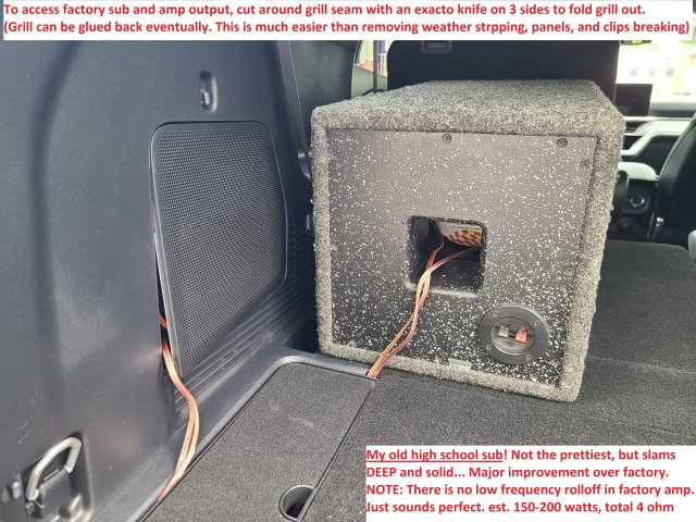

I've connected the factory sub amp to a 10" subwoofer in a ported bandpass box, and it sounds phenomenal! HUGE IMPROVEMENT. I estimate that it's about twice as loud and twice as deep, while sounding much cleaner and smoother. For anyone who wants to add some deep and loud bass you can feel in your chest, this is the easiest option. It greatly improves the quality of the overall sound spectrum. The smooth, deep bass compliments the mids and highs so well. And if you want to set the bass higher than -7, the rearview mirror can shake over an inch.

Cut around the factory subwoofer grill seam with an "X-acto" knife. Cut on 3 sides so that the grill can be folded out, exposing the factory sub. I left one side attached as a hinge, which is helpful to hold it aligned in place. While "destructive", this is a better option than taking out weather stripping and paneling to access sub, which breaks clips and loosens everything. It's just far easier and less invasive to just go through the grill in my opinion. Also, the grill can simply be glued back in the seam to restore it to original condition, and no one would ever know.
2. Remove the factory sub with only 4 screws holding it in place (only the result is shown below)
3. Connect factory sub amp outputs directly to a dual voicecoil subwoofer (4 ohm each coil). It's recommended to use a 10" to 12" sub in a ported box. The subwoofer would be relatively low wattage with a high sensitivity of 90db+ SPL (e.g., JBL Stage 122D).
The ford wiring has purple=positive and black=positive. (NOTE: I've verified all of the output properties with a multimeter, and the results are fantastic).
SEE PHOTOS WITH DESCRIPTIONS BELOW:
