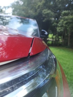

Without the rubber strip on the hood, the hood slams down on the light strip, right? Is that a concern? Is it possible to attach the light strip forward of the rubber?
I tried installing one with the rubber strip still on the hood and no matter how far out I put the light strip the hood wouldn’t close.
There are height-adjustable "stops" that control how far down the hood goes (also control alignment of the hood and the fenders). Turn those down a few turns and see what you get. I had to turn mine up to make the hood/fender alignment better.
Wouldn’t that make it misaligned with the fenders though?
It can. When I bought mine, the hood was lower than the fenders. I got that cured. When I added the light strip yesterday, I had to lower the hood just a pinch so it would latch. It still sits a bit above the fender lines.
Use the posts near the front of the hood (there are four). I had to turn mine down about two turns to get the latch to cooperate. Not a big deal - the hood/fender alignment is still good.
Any chance to see some photos. Maybe from the front and the side (hood/fender alignment)? Thanks!
