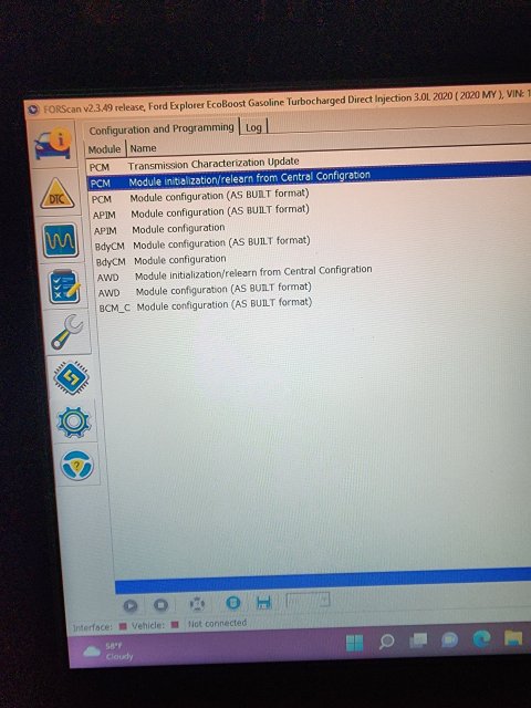

I can not find the ACM page/screen. I get this far and am scared to adjust something. Please advise.

Can I access the FENG and ANC throught these drop downs? I can't find the ACM page only this page (see attached)
Which dongle are you using? I had to switch to the OBD link EX after I couldn’t connect to the ACM module with my ELM327.
