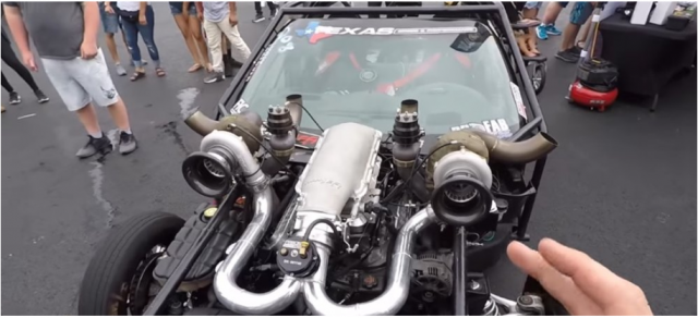

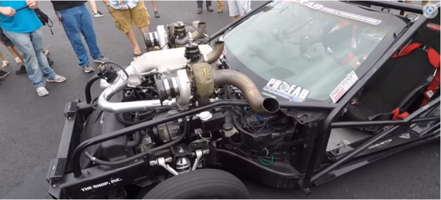

Then why do all those turbo drag cars have such short, fat pipes exiting out the hood/front fender? According to what you said above (and in the previous portion in the post you linked), they are leaving inertial energy on the table, thus not making their car as fast as it could be. True, the pipe does have a sharp-ish change in direction, as it must for packaging reasons as well as those you listed in your post, so there's that going for it. But what about the rest? Where's the cat that helps laminar flow? Where's the smaller diameter pipe that helps with velocity? I mean these things are "straight" pipes off the turbo, often 3" to 4" in diameter. These cars match your scenario above. They are at WOT. They have to shift. Why aren't they running longer, or smaller pipes? Why aren't they wrapped, to keep the heat? Why aren't they designed to increase velocity, so as to help reduce backpressure?

See, here's where I think you have gone astray. You said this:
Assume you're at WOT and you upshift. RPMS drop by 2000, and so does the exhaust energy exiting the exhaust port. Because the turbine still has a huge load due to driving the compressor, its RPM will drop precipitously.
Why should the turbo RPM drop so much? It's spinning in excess of 140,000 RPM's, with all the mass of the compressor, turbine, and shaft also spinning. In the sub millisecond it takes for our auto trans to shift, the RPM's are not going down all that much. Some, yes. And even if you lose 2000 RPM's on the engine (and thus exhaust gas flow) from the upshift from 6K, that's still 4K RPM's on the engine, more than enough exhaust gas flow for full boost. As soon as the trans re-engages, the turbo is making full boost again almost instantaneously. Want an example? Put a boost gauge in. Or get the live data from ODB2. Do a pull. Keep your foot in it through a number of trans shifts. Do you see the boost value dip at all? On a manual car, where you can hold the trans disengaged (clutch in) between shifts, then you will see the dip. The longer you hold the clutch in. On these trucks? With shifts that last the snap of a finger? Full boost all day long.
Whatever minimal gains you think you will see from optimizing an exhaust flow downstream to help generate velocity, will be far outweighed by the sheer presence of boost. Conversely, whatever small gains you lose by not having an optimized exhaust, as you describe, are easily overshadowed by that boost. If you have to sacrifice a little efficiency to get boost, and get to it sooner, the trade-off is worth it. Which is why these drag cars run the exhausts that they do. Because the trade off is worth it. Your theory is sound. And on a NA motor, that needs as much help as possible to fill to 100% VE, it's worth it. Every little bit helps. On a boosted motor, that can fill 140% VE and more, with a sewer pipe hanging off the turbine? Well, if you want to go faster, you do what you can to let that turbo spool, baby. Everything else is lost in the noise.
Can you force 500 hp through the stock exhaust? Absolutely. As proven by the dyno chart you have referenced. Well, that's a turbo for you, that's forced induction. Emphasis on forced. But just because you can push that power through the stock exhaust, doesn't mean that's the best way to do it.
