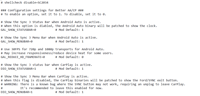

Anyone running the full screen with none of the Sync3 buttons at the bottom? Interested to see how it looks and any feedback. By default the sync3 buttons are enabled.

There are some settings to change depending on what menu bars you want displayed in the config file. Disregard the message about a but on the last setting, this is a file from a beta version before it was patched.
