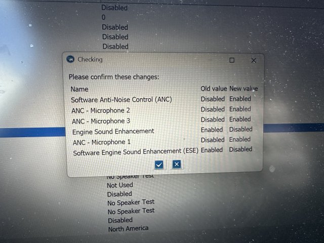

Is anyone having a tough time finding anything FENG related in a 2023? I tried 3 seperate obd connectors and nothing as far as software or engine sound enhancement
On my '23 it's in the ACM
Disabled "Engine Sound Enhancement" and "Software Engine Sound Enhancement". Threw it in Sport mode and that seemed to have done the trick.
Separately, I also turned on Software Anti-Noise Control and the three ANC microphones. WIll give this a try and see what it's like. Not necessary to shut off the FENG (EDIT: doesn't work see below)
ESE and Software ESE are what need to be disabled for FENG delete
Edit. I did fine some error codes in the ACM module for the ANC microphones. Error was shorted or open. My guess is they are not present, so the ANC won't work properly if you enable it. SO i turned the ANC feature off again. No idea where the microphones are located to add them.
Interestingly enough, with only the FENG turned off i had a DTC in the APIM for "improper configuration". Everything seemed to work ok. Did a few DTC resets and key cycles and it never cleared.
Drove around a bit with the FENG off and didn't like it. I don't have an exhaust on my ST, and the V6 engine noises don't really sound that great. Ended up putting the FENG back on, which did get rid of the APIM error code.
