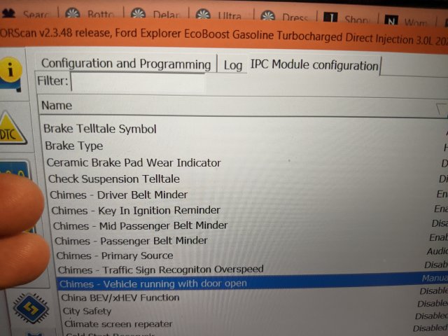

I just got a cable so I can use FORSCAN to change a few things. Something that I have not seen anyone talk about disabling is the Door-Open Chime With Engine Running.
I have never had a vehicle that chimes when I open my door and it drives me nuts and sometimes wakes up the baby in the back. Anyone know if this is also something I can tackle when I get around to using FORSCAN?

Well I figured out how to shut it off with FORSCAN! So much better not having that annoying chime.
I think I found where to shut off the chime that activates when you start the vehicle as well but I wasn't sure and am going to do some digging before touching it to make sure I am not doing something bad. I think it's in the above photo under "Chimes - Key In Ignition Reminder" but it doesn't make sense to me to be that but I'll probably just try it and see what happens.

Did you just change it to "disabled" or to "manual"

I changed it to 'disabled'. I have to go back in some time soon to make additional changes so I might play around with it to find out what the difference is between; manual, automatic, disabled.
