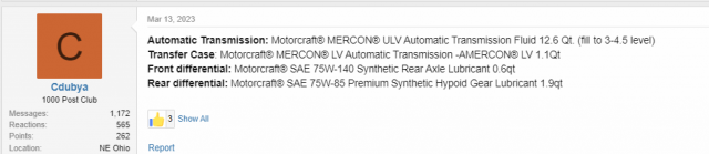

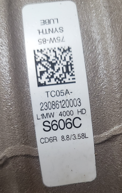

Interesting that it states 3.58L Which is almost 4 quarts. Interesting that the manual calls for 1.9qts

But....That might be the gear ratio as well... who knows. But I don't think we have a limited slip. I'll drain it tommorow and refill and see what is up

8.8" is the ring gear diameter, 3.58 is the differential gear ratio, don't put that match lubricant in it.
