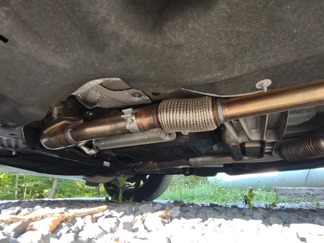

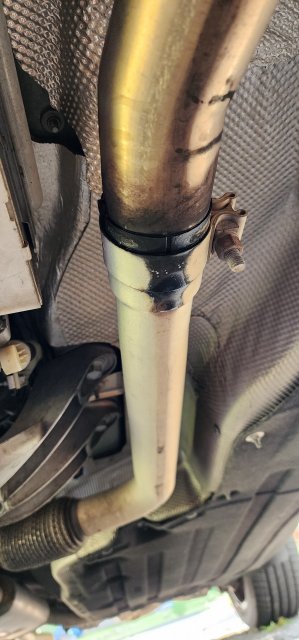

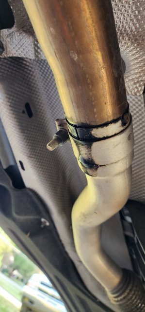

We had our cats and flex pipes replaced about 10k miles ago, when they did the 2nd oil pan replacement. Here are pictures of the leaking from every single joint on the couplings for the exhaust. On a cooler morning, ou can see the condensation and steam coming out of every single joint. They said that's normal and they all leak on Monday 09/25. I guess we'll have to take it to the other Ford dealer in town.

Stop screaming and read. The flex pipes ARE NOT LEAKING OR RATTLING,THEY HAVE BEEN REPLACED ALREADY.
