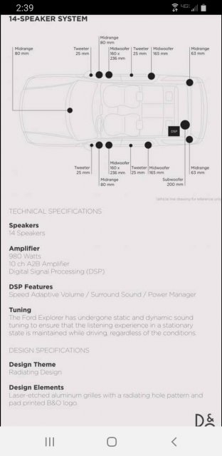

I'm going to be using the onboard DSP in the Alpine Amp and a AudioControl DM-RTA Pro Kit to dial it in.. I'll be splitting two of the six channels to make 8 going into the amp. That way I can power all 14 speakers like I wanted.
1- FR
2- FL
3- RR
4- R D Pillar
5- RL
6- L D Pillar
7- Dash
8- Subwoofer
So quasi-active. There’s really no reason to RTA that…you’ll still have the passive XO’s in place so you won’t be able to set TA or phase. For everything else just set the high and low pass filters and hope it sounds half way decent.
I really don’t understand the reasoning behind keeping 14 speakers…it’s pretty pointless. More doesn’t equal better…it only makes things harder to tune and make cohesive. I’ve been doing high end car audio for decades…this recipe isn’t making much sense.

You're right! I was reaching for something that's just not there. I was thinking the dash and D pillar speakers would add something but it's just not going to work. Not unless I ran multiple amps and put each speaker on it's own channel. Like you said, it just makes it more complicated and harder to tune. I just wanted to upgrade what's there with something better hoping it would sound better. I've done a lot of systems myself but nothing like this system. I'm an ameture! I've never had to deal with a factory amp or anything like the Sync3. I haven't done anything like this in about 20 years either and a lot has changed! The last good system I did was in my 1993 Ford Escort. I used A/D/S 236is components in the doors, can't remember what I used in the back but they were also A/D/S, 2 Lanzar KH12 and an A/D/S PH15 6-Channel amp to power it all. The HU was an Alpine CD player. That was high end back then! So I think I'm just going to listen to the professionals and keep it simple. Front doors, back doors and a sub.

New plan. Going to use a Toslink out of the ZEN, as suggested, to an ArcAudio Blackbird to actively power the front door 3-ways individually, passively power the rear door 2-ways, come out channels 9 & 10 into an ArcAudio Nighthawk to power an Alpine 12" sub. I'm ditching the dash and D-pillar speakers as suggested. I don't know much about ArcAudio but from what I've read, they seem to be a reputable amp. This should get me to where I want to be and be better to tune. What do you think?
5,655
6,828
#46
I think you’re on a much better path.
