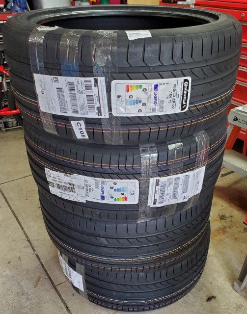

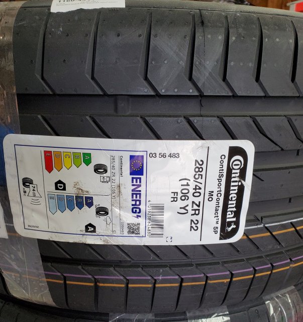

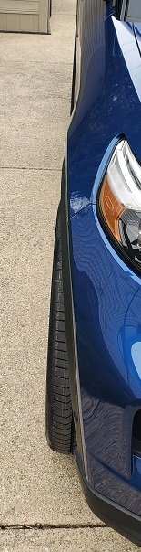

The TPMS sensors showed up Saturday. I have an appointment for the Tire Rack mobile tire installer truck on Wednesday at 3PM. I now have everything I need, just need to get them mounted. For now here is some pics

Tire Porn! I've had good luck with Continentals in the past.
2,070
1,444
#44
Nice tire! I ran some Continental summer only tires on my CTS-V for a year. They were pretty good and sticky, not great in wet, with minimal mileage......did I mention they were good and sticky :) I'm curious how you like them.

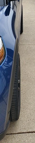

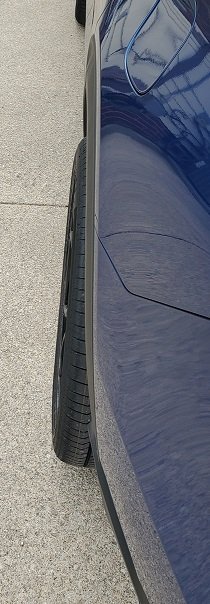

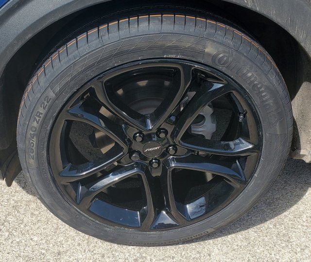

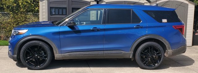

They came and mounted and balanced my tires today.
I have 1.25" front and 1.5" rear bora spacers and they give just the right amount of poke.
