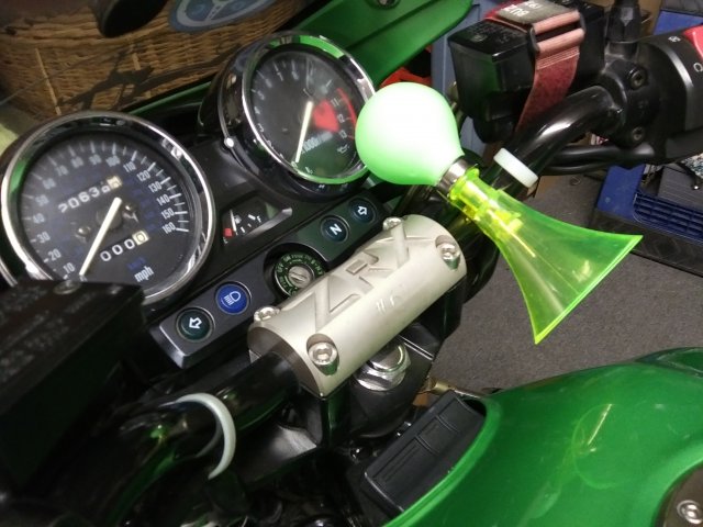

However, my latest horn installation was a bit easier... (sounds like a dogs squeaky toy...) 20220219_183002[1].jpg
