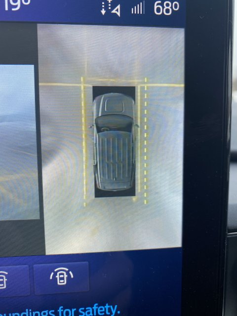

I don't remember the birds eye view camera doing this when new. when i park into a parking spot, i hit the camera button on the dash to see if I've pulled forward enough. it seems the front view is not aligned with the sides. does anyone else's do this or should i bring it in for re-calibration?

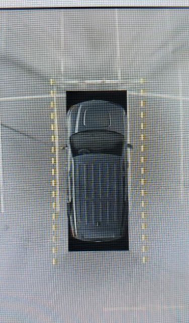

My 360 image distortion is brutal. I feel like it's getting worse.
Complained to my dealership, they said there was nothing they could do.

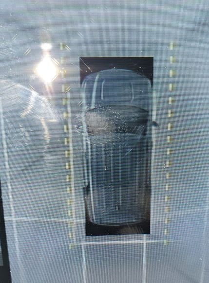

So my dealer recalibrated mine. No change.
Edit: no change. they suggested it may be the lowered suspension?

Mine looks the same. It was pretty good when i first got the Explorer but 6 months and 6500 miles later it looks like this.

The dealer told me to stop by "weekdays at 2pm the camera guy comes by, except Fridays, no appts." - seriously. Skeptical, I showed up on a Wed at 2pm. Sure enough, the guy showed up, takes the car, attached laptop, drove it to the back lot (I guess to find large area with open lined parking spaces), and ~10 minutes later all was aligned. The black box is still there but the cameras are aligned very well now. No paperwork or documentation. It was odd but I'll take what I can get!

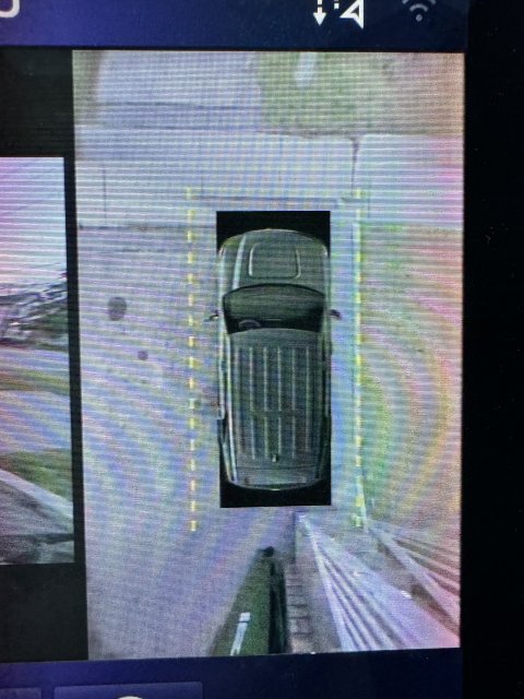

Posted this somewhere else. Same here, this issue started occurring few months after purchasing my 2021, and it does seem to be getting worse. I took it to Thorncrest Ford in Toronto and they claimed the issue couldn’t be replicated. IMG_0760.jpeg

So I went back to Thorncrest Ford in Toronto for the rear axle bolt recall and they told me they would fix the camera issue (but they were referring to the blue screen on the reverse camera) so I showed them all the pictures from this forum to help them understand what I was actually talking about. I picked up my 2021 ST 4 hours later with the misaligned 360 degree camera issue fixed and the blue screen recall completed. Unfortunately, they’re still waiting for specialized tools and parts for the rear axle recall repair.
