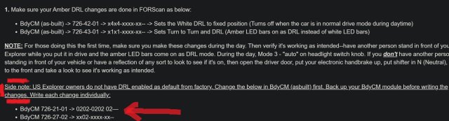

I had no issues getting the amber DRL's to work on my 25 ST. There is a more detailed thread that I will link here. Take your time, follow the instructions and you shouldn't have any issues. This thread addresses using the ambers at night as well, but it is also a more thorough guide to getting started. It worked for me when I followed the instructions. To get you amber DRL's working during the daytime, you only need to follow the instructions under "STEP #1". The rest are OPTIONAL instructions explaining how to get your ambers working at night with fog lights only.
https://www.explorerst.org/threads/now-possible-amber-drl-led-bars-at-nighttime.8974/

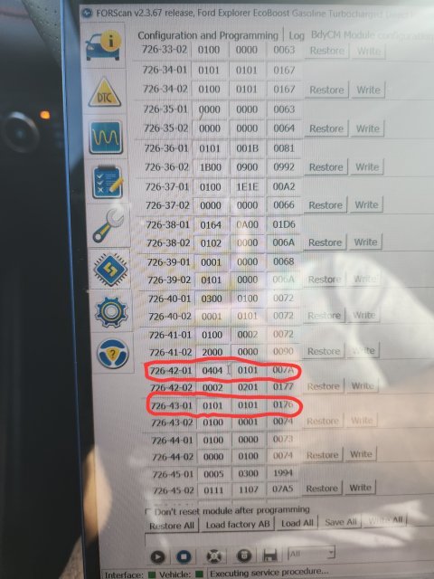

I'll post a picture of what im seeing on my laptop.

Looks good. Did you also check this?
When you are finished, you will need to have your vehicle in Drive to see the results. You will not see ambers in Park. Have someone outside the car check for you or pull up to a store window in Drive to check.

No, I didn't do lines 21-01 or 27-02. ‍
I'll have to get to this another day. Today is gonna be a late one for me.
I honestly didn't think that would apply to me. Smfh. Thank you for pointing that out to me.
Made no difference.

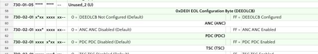

I need help disabling Pull Drift Compensation (PDC). I change one of the "F's" to a zero but it wouldn't take. Any ideas? The steering in this car is driving me bonkers and I highly suspect this as the culprit.

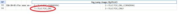

I've been digging through the spreadsheet looking for the right place to turn on my fog lights all the time. Thinking to turn them on with the DRL's, is the correct spot to do this? Fog DRL As Built.jpg
