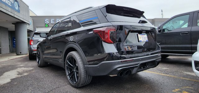

The saga continues...14 weeks and a boat load of money, I've got the black plastic trim on my Explorer back to stock. Every shop I've talked to since has told me they can't/won't paint textured plastic due to the mold agent in the plastic which causes the paint to peel. There was a promoter they used to be able to get, but it has since been banned in the state due to containing certain chemicals. Pretty frustrating to be sure. Explorer went in at 1 week old in perfect condition and they FUBARed it.
I picked it up from the original shop and took it to one of the premium shops, Cascade Collision, with no trim so they could get it back to stock. I've worked with the manager on various projects for over the past 10+ years and he has always exceeded expectations. This time was no different. The first shop clear coated both front doors but neither prepped not removed trim. As you can guess it started flaking off the very next day. I took it to Cascade this past Tuesday just to get trim put back on. He didn't think he could get the doors repaired until I returned from training. He was also missing a few trim pieces which would go on after as well. Day two he calls to let me know the paint shop will actually have time to priority sand and repaint the doors. Still within the promised 4 days. All in all, they communicated very well, under promised and over delivered. I knew what was happening every step of the way and even had a completion date/time which they crushed. I got a call before they promised and found they got EVERYTHING done. They were even able to find the trim pieces they were missing.
Also on the bright side, since all the trim was replaced anyway, I was able to replace it with ST trim which I like a whole lot more. More aggressive looking and overall a more appealing in my opinion.
I guess with the ST trim the Explorer looks like the St-Line. ST-Line exterior, Platinum interior, ST engine and soon to be front axle, Timberline rear axle, PIU rear subframe. She's really turning out to be quite the Frankenstein mobile.

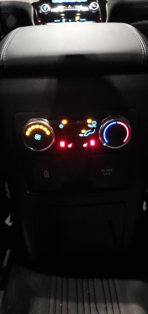

Installed the rear controls tonight. Likely THE easiest install to date. Used a trim removal tool from the top and the rear center console panel came right off. Removed the wireing harnesses to the rear plug and USB ports, removed 4 torx screws, and removed the blank cover. Lined up rear controls with their guides and pushed into place, replaced the 4 screws, removed tape holding wiring harness to center console and plugged all three wiring harnesses back in (there all different sizes, so can't go wrong). Rear cover popped right back into place. Easy peasy, captain cheesy.

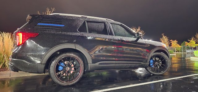

I finally got the Steeda springs, struts, and shocks installed along with the wheels and tires. While I was at it, I had the calipers painted blue, since the Platinum comes with an unfinished silver. I think it looks a bit better but sure does highlight how small the brakes are :LOL: I'll get some big brakes eventually...
I don't have many good pictures, so this will have have to do for now.

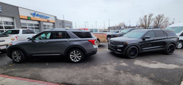

When dropping the Explorer off to the dealer I parked behind a stock Platinum and was a little surprised by how different mine looks compared to when I brought it home.
Yet again, not the greatest picture. It appears that I'm not the greatest photographer :geek:
