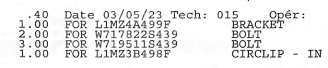

Follow-up: after a road test, the technician confirmed the vibration problem from the drive shaft and said that a message in "Oasis" had a fix for the problem. They ordered 4 parts (1 is BO) to provide the fix.
Can't tell if it's going to solve yet, but the following was ordered (it's in French, so description could vary):
Do you perhaps have a service bulletin code?

#56
I don’t have it written on the paper they gave me for the parts ordered… I can update when fixed (if fixed of course!)
