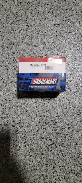

So I am seeing 2 different BOVs models from Turbosmart (disregarding VTA and recirc options) - VR2 and VR13.
Can anyone provide any info as to the difference or any compatibility issue? I ask because I ordered one and was sent the VR13. But I see on FGB video and see that people have (also) installed the VR2. I have been trying to get an answer from Turbosmart but once the Australian contact (really nice guy) sent me to their US Support, crickets... I wouldn't want to install the VR13 I was sent only to find an issue... Thanks!

They are nearly identical, the main difference is the orientation of the solenoid on the cap.

Per Turbosmart, you want the VR13 (TS-0223-1X96) for the Explorer ST. The 'X' is the placeholder for the VTA or Plumb back version. I got the Plumb back version b/c I didn't want any emissions test issues..
