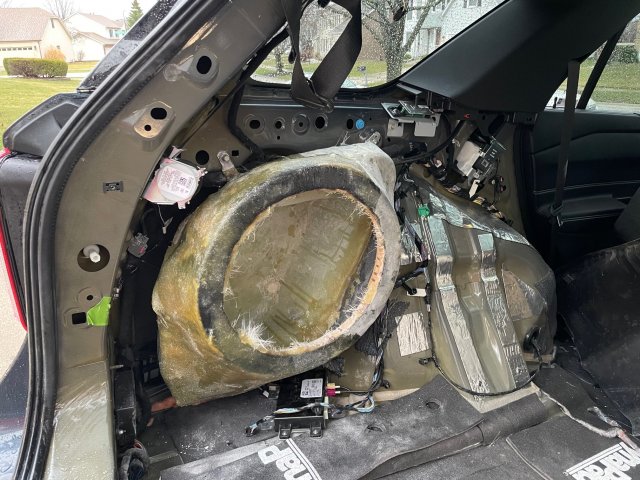

Started with some sound deadening and a JL Audio TW5v3 sub in the factory location. I hacked together a cardboard mold to get the shape I wanted. Built up the layers and mounted it to fasten the brackets to use the factory bolts for installation. Test filled with water and I have more space than I need.
Here are the first presentable pic.
And here it is in place so I could fiberglass the brackets in.
Next I have to calculate the additional space when I install the speaker ring and move the sub out towards the trim panel. Then trim down the shell and start fabbing the face and speaker ring.

So today I trimmed the box down to an estimated size and tried to fit the plastic panel. No dice. The top of the box is about 1" too high for the panel to fit over. Guess I should have looked at that when I made the form. Anyhow, going to trim it down and apply some more fiberglass then on to the ring.
I think this is about the biggest sub you could fit here. As it is I will be cutting into the panel quite a bit and the ring barely fits on the flat part of the panel and cuts into the vent on the bottom a bit.

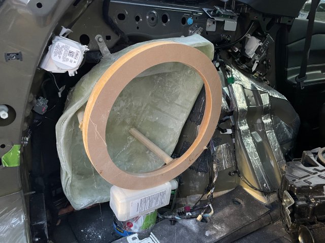

Well just posting a quick update. Fiberglass sucks and I suck at fiberglassing.
Did a couple rounds of trimming and re-forming some areas. While I have enough volume, the speaker ring is larger than the dimensions of the box by about 1-2 inches in a couple spots. Since I have about 3-4" from the current face of the box out to the plastic trim panel over the sub, I decided to cut down those areas a bit and shape it up towards the sub ring for a more gentle transition and to make sure there was plenty of room for the speaker.
I am intentionally not posting more pic yet. As I said I suck and am embarrassed at my fiberglass skills:eek: Hopefully I will post a few tomorrow after I get the ring secured and start to fiberglass the face.
In hindsight I think it might have gone a lot better if i got a bit block of Styrofoam and cut it to fit completely in the area. Then carve out what i wanted the shape of the box to be and use that as a mold. My troubles started immediately trying to shape a mold out of cardboard that was not strong enough to do what I needed.

Well I got the ring positioned and I'm pretty sure it will fit with the panel on. Now for some fleece and fiberglass. Then I have to see how much volume I end up with. I'm afraid I may have had to trim a bit too much too get it to fit, might have lost too much volume. Trying to make up for a bit of the lost space when I fleece. Lettign the glue dry good and cold and then I will try some fleece. If I don't have enough volume I think I've decided to use the current box as a mold. I can use body filler or cut and fiber to expand in the places I need to expand and then tape and foil it to use as a 3 sided mold for the second attempt. Ring.jpg it of it with the fleece.

Well she fits....well pretty close. Sub box is installed and fits but I think it may be 1" too far out for the panel to look right. Think I'm going to start cutting out the trim panel to find out exactly how much I need. If it is an inch or less I will probably reinforce the ring and cut an inch off the outside.
I actually surprised myself. The first cut for the ring fits pretty darn good and it is perpendicular to the floor.

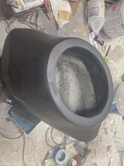

Finished the outside of the box. Need to clean up the inside.

Thread Starter #20
