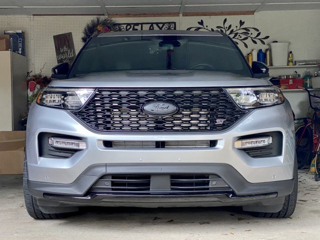

Looks good on a silver one.
Best part is only people that know these vehicles have a chance at spotting it.

Got the grill shutters removed. I painted the intercooler front with a light coat of flat black stove paint. Now that the shutters are gone the lower portion of the radiator(which is silver) is now exposed so I may have to paint that too.
The top bracket on the driver side intercooler (rear bracket) wouldn't drop into the existing slot. I installed 3 small flat washers between the intercooler and the bracket and that fixed the problem versus bending the heavy bracket. The hole for the screw for the intercooler sensor was threaded too shallow so I had to add three washers so the factory screw for the intercooler sensor (#27 torx) wouldn't bottom out in the hole and leave the sensor loose.
