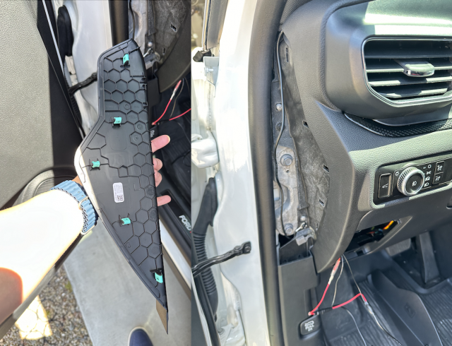

For anybody looking for a good close ground that is not under the brake pedal, pop off the plastic panel next to dash. THere's a trim screw that connects to the ground that the fuse panel connects to as well.
