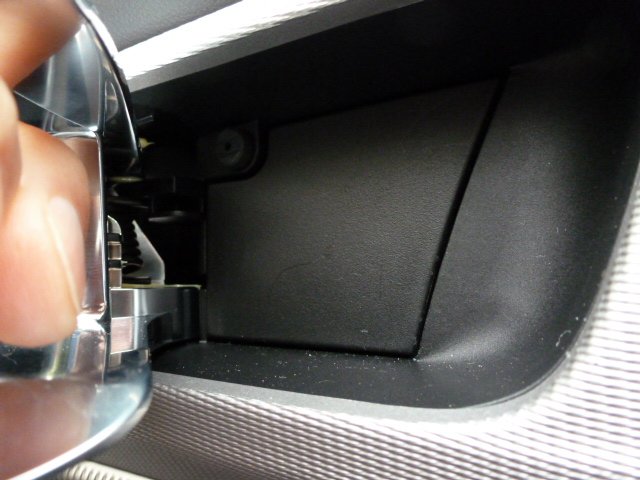

Thanks for the picture. I wish mine looked like yours---It would be easy to remove with that little notch in it to put a 90 degree pick in, but mine are totally different. Here's a picture of mine---No notch.

Just stick a pick in the gap and twist it. It’ll pop right off.

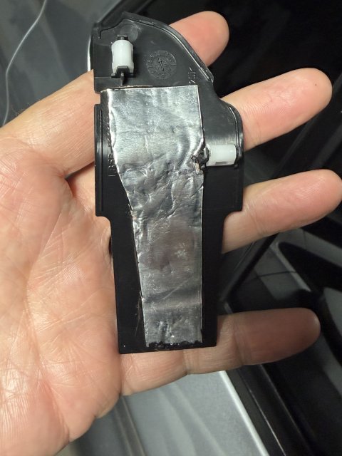

Well, you were right about the pick. I ordered a miniature pry bar set and a miniature pick set from Amazon. The pry bar set didn't have the right shape pry bar to get in between the block off plate and the door panel, but I was able to get one of the picks behind the plate. Just like you said--One twist and 2 of the clips released, and I repositioned it and the third one released and the block off plate popped right out. Here's a picture of the plate out of the door. I really didn't want to use a pick for fear of scratching something, but it all worked out fine. Thanks for the tip.
