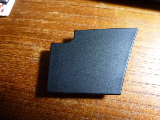

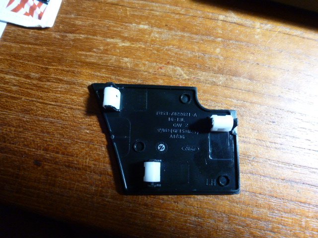

Well, you were right about the pick. I ordered a miniature pry bar set and a miniature pick set from Amazon. The pry bar set didn't have the right shape pry bar to get in between the block off plate and the door panel, but I was able to get one of the picks behind the plate. Just like you said--One twist and 2 of the clips released, and I repositioned it and the third one popped right out. Here's a picture of the plate out of the door. Thanks for the tip.
