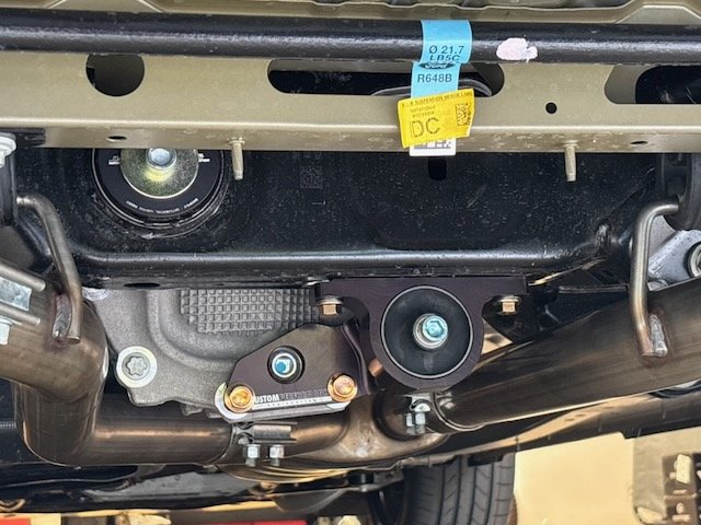

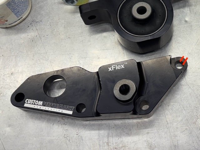

I installed mine (cp-e) last night. For the life of me, I couldn't figure out how to remove the top passenger side bolt, there wasn't enough clearance to get the bolt out with the subframe right there, I'd have had to drop the diff down a bit or angle it severely somehow. That is above my pay grade so I notched the bracket to slip over the bolt and then tightened it down, maybe I'm an idiot (no, I'm definitely an idiot) and there is an easy way to get that bolt out.
Thankfully I saw Lethal's video for the idea. I didn't take an after pic of the cutting, but used a cutting wheel on my grinder to notch the bracket where the red lines are.
IMG_3809.jpeg IMG_3811.jpeg .
As for the e18 box wrench, I would suggest getting the ratcheting kind for more maneuverability - I ended up removing my passenger side tail pipe so I could get enough torque on it, a regular e18 doesn't have a lot of range of motion with only 6 positions on the bolt head.
I did the JXB insert and hardened bolt at the same time. Ready for hard launches now.

100%. And seeing how that top right bolt doesn't clear the subframe, I think ID/cp-e would be better off with a notched bracket like the Lethal video shows and I made myself. I'm sure it doesn't do structural integrity any favors, but I still have 3 +3/4 of the bolts fully holding that brace in place, it isn't moving.

Competitor models are slotted for those upper bolts……
